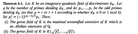

Statement 3: Finding the HCF for $K=\mathbb{Q}(\sqrt{-n})$ is difficult. However, when $n$ is one of Euler's 65 convenient numbers then the Hilbert class field of $K$ equals the genus field of $K$. The genus field can be easily determined as follows:

  • Construct a primitive element for the genus field (cf. here)
  • Next, from the minimal polynomial of the Hilbert class field, I want to recover congruence conditions through quadratic reciprocity.
