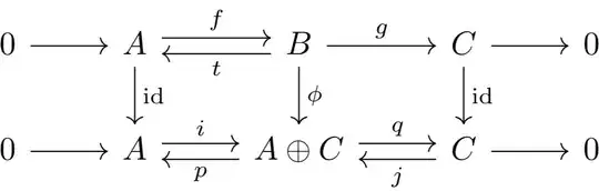

Just saw this: there's a far simpler and more intuitive proof using the short five lemma.
Letting $i:A\to A\oplus C$, $j:C\to A\oplus C$, $p:A\oplus C\to A$, $q:A\oplus C\to C$ be the $4$ morphisms characterizing $A\oplus C$, consider the following diagram
Clearly, the upper short exact sequence splits on the left. $\phi$ is defined as the unique morphism such that $t=p\circ\phi$, $g=q\circ\phi$. It's easy to show that this diagram commutes. Thus, by the short five lemma, $\phi$ is an isomorphism.
A pretty similar proof works for splitting on the right as well.

    The snake lemma can be used as well. Note also that the proof for the right one follows from the left one, as the argument for the left one is valid for all abelian categories, and so one can reduce the right case to the left one by taking the dual of an abelian category. – wlad Mar 23 '23 at 11:08
    That is one beautiful diagram! :) – Daniel Donnelly May 11 '23 at 00:22
