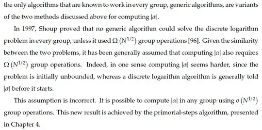

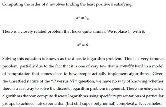

The least $\,n >0\,$ such that $\,a^n\equiv 1\pmod p\,$ is called the order of $\,a\pmod p.\,$ For the state-of-the-art on the order computation algorithms see Andrew Sutherland's 2007 MIT Thesis Order Computations in Generic Groups. Below is an excerpt from p. 14.
