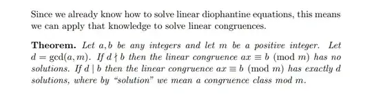

The question where I got this from comes in two parts. The first is that it asks to find the set of the inverses of $7 \mod 13$, which turns out to be $[2]_{13}$ but, I found that solution by solving the linear diophantine equation $$7x - 13k - 41$$ which is just the original equation in disguise i.e. $7x \equiv 41 \mod{13}$.
Now, I'm terribly confused as to the solution of the congruence equation. Where am I going wrong and how should I proceed?

The OP states
... but, I found that solution by solving the linear diophantine equation
From this site I found
Here the equation is $7x\equiv 41 \pmod {13}$ or
$$\tag 1 7x\equiv 2 \pmod {13}$$
Here also, multiplication $7 \times x$ is repeated addition. So you can also get the inverse of ${[7]_{13}}^{-1}$ and/or the solution of $\text{(1)}$ using the same technique (might as well cycle through it all):
