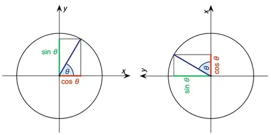

An explanation without words:
The word "cosine" was earlier written "co. sinus", short for "complementi sinus", which (in Latin) means "sine of the complement", i.e., $\sin (\frac{\pi}{2}-\theta)$.

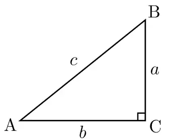

This is easily verified in the trigonometric definition of the sine and cosine, i.e. in a right triangle.
Right triangle
(Picture from Wikipedia)
The definition of the sine of an angle in a right triangle is the ratio of the side opposite the angle and the hypotenuse:
$$\sin\left(\angle A\right) = \frac a c$$
The definition of the cosine is the ratio of the side adjacent to the angle and the hypotenuse:
$$\cos\left(\angle A\right) = \frac b c$$
Observe that the side opposite the other angle, $\angle B$, is $b$, so we get from the definition:
$$\sin\left(\angle B\right) = \frac b c$$
But, since this is a right triangle:
$$\angle B = \frac \pi 2 - \angle A$$
giving what we wanted.

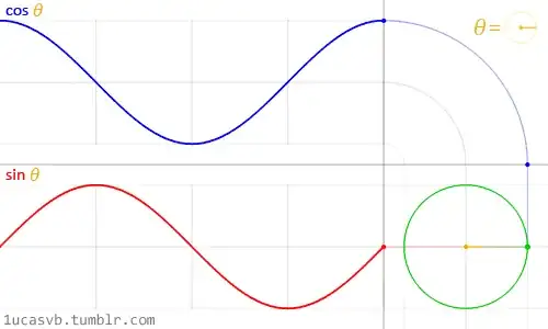

For visual people like me, this animation makes the relationship intuitively understandable:
animated unit circle (sine & cosine)
Sableraph
