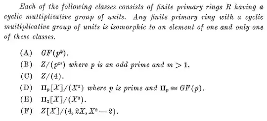

A quick google search finds the paper Finite Rings Having a Cyclic Multiplicative Group of Units by Robert W. Gilmer, Jr. which settles the question as follows:
This is complemented by proving that every finite commutative ring is a direct sum of primary rings and that its group of units is the direct product of the group of units of the primary rings, and is cyclic iff each part is cyclic and they have coprime orders.

  • Which of these cases covers ${\bf Z}/2p^r{\bf Z}$, $p$ an odd prime? – Gerry Myerson Oct 18 '11 at 02:30
  • @Gerry, these are not primary rings. Please see the complete first page in the link I gave. – lhf Oct 18 '11 at 02:32

  • @lhf, then you are saying that the theorem you have quoted does not settle the original question, it just settles it for primary rings? – Gerry Myerson Oct 18 '11 at 04:25
  • @Gerry: The paper settles it for commutative rings. There are definitely non-commutative finite rings with cyclic groups of units not of that form. – Jack Schmidt Oct 18 '11 at 05:07
  • @Jack, thanks, but the ring I asked about several comments up is commutative. The paper may well settle the issue for commutative rings, but I don't see how the one theorem cited by lhf settles it for commutative rings. – Gerry Myerson Oct 18 '11 at 06:09
  • @Gerry, I've updated my answer. – lhf Oct 18 '11 at 11:14
