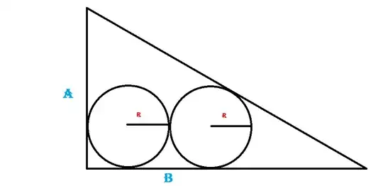

The other day I was playing with Ms Paint drawing circles here and there - I coincidentally drew a circle inside a right angled triangle which I already drew. Strangely A problem struck to my mind and I tried solving it , but I was unable to do so. I put forward the statement of the problem which I managed to frame myself:
Problem: The legs of a right angled triangle are of length $a$ and $b$. Two circles with equal radii are drawn such such that they touch each other and sides of the triangle as shown in the figure. Find the radius of the circle in terms of $a$ and $b$.
Figure (of course my MS Paint one)
For reference
Further Scope - Is there any way to generalize this for other shapes or for any other triangle?

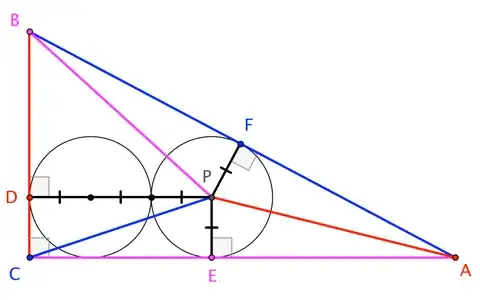

Writing $a := |BC|$, $b := |CA|$, $c := |AB| = \sqrt{a^2+b^2}$, and $r = |PE| = |PF|$ (so that $|PD| = 3r$), we have $$\begin{align} |\triangle ABC| &= |\triangle ABP| + |\triangle BCP| + |\triangle CAP| \\[4pt] \implies \qquad \frac{1}{2} |BC||CA| &= \frac{1}{2} \left(\; |AB| |PF| + |BC||PD| + |CA||PE| \;\right) \\[4pt] \implies \qquad a b &= c r + 3 a r + b r = r ( 3 a + b + c )\\[6pt] \implies \qquad r &= \frac{ab}{3 a + b + c} = \frac{ab}{3 a + b + \sqrt{a^2+b^2}} \end{align}$$

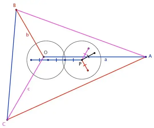

To address @DanielV's suggestion of generalizing to higher dimensions, consider a right-corner tetrahedron $OABC$, with right corner at $O$ and edge lengths $a := |OA|$, $b := |OB|$, $c := |OC|$. (Note that I'm changing notation slightly from the above.) Let a sphere with center $P$ and radius $r$ be tangent to the faces around vertex $A$, and let a congruent sphere (tangent to the first) be tangent to the faces around vertex $O$. Then $P$ has distance $r$ from faces $\triangle OAB$, $\triangle OCA$, $\triangle ABC$ (the ones touching $A$), and distance $3r$ from face $\triangle OBC$ (the one opposite $A$).
Here's a poor attempt at a diagram:
(In this case, the altitudes from $P$ are color-coded to match their parallel counterparts through $O$. The black altitude is to face $\triangle ABC$.)
Thus,
$$\begin{align} |OABC| &= |OABP| + |OBCP| + |OCAP| + |ABCP| \\[4pt] \implies \qquad \frac{1}{6}a b c &= \frac{1}{3}\left(\; r\;|\triangle OAB| + r \;|\triangle OCA| + r\;|\triangle ABC| + 3r\;|\triangle OBC| \;\right) \\[4pt] &= \frac{1}{3}r \cdot \frac{1}{2} \left(\; a b + c a + 3 b c + 2\;|\triangle ABC| \;\right) \\[6pt] \implies \qquad r &= \frac{abc}{3bc + ab + ca + 2\;|\triangle ABC|} \qquad (\star) \end{align}$$
Fun fact: The Pythagorean Theorem for Right-Corner Tetrahedra says that $$|\triangle ABC|^2 = |\triangle OBC|^2 + |\triangle OCA|^2 + |\triangle OAB|^2$$ so that we have $$|\triangle ABC| = \frac{1}{2} \sqrt{\; b^2 c^2 + c^2 a^2 + a^2 b^2 \;}$$ and $(\star)$ becomes $$r = \frac{abc}{3bc + ab + ca + \sqrt{\; b^2 c^2 + c^2 a^2 + a^2 b^2 \;}}$$
In $4$-dimensional space (where there's an analogous Pythagorean Theorem, as there is in any-dimensional space), we have $$r = \frac{abcd}{3bcd + acd + abd + abc + \sqrt{\;b^2 c^2 d^2 + a^2 c^2 d^2 + a^2 b^2 d^2 + a^2 b^2 c^2\;}}$$ and so forth.
Incidentally, the matching-notation version of the initial answer is $$r = \frac{ab}{3b + a + \sqrt{\;b^2 + a^2\;}}$$

  • Nice diagram. Any reason for the coloring? – qwr Mar 22 '14 at 07:53
    @qwr: Thanks. :) As for coloring: I just like to highlight the association of a vertex with its opposite edge in a triangle, and other elements get their colors accordingly. I chose not to color-code the altitudes dropped from $P$ to the edges (I had reflexively done so in a "draft" image), in order to tie the congruent segments together visually. – Blue Mar 22 '14 at 08:00

    @AJP: "$|BC|$" represents the length of segment $\overline{BC}$. (I often leave out the over-bar to save typing.) By analogy, I use "$|\triangle ABC|$" for the area of $\triangle ABC$ (and then "$|OABC|$" for the volume of tetrahedron $OABC$, etc); this is non-standard, but I like it. :) The symbol ":=" indicates "is defined to be"; writing "$a:=|BC|$" says "I'm going to write '$a$' for '$|BC|$'". Others (even I) might otherwise write "let $a = |BC|$", but using ":=" is ever-so-slightly better, as it distinguishes definition "'$a$' means '$|BC|$'" from relation "$a$ equals $|BC|$". – Blue Mar 22 '14 at 13:10
  • It is a very nice proof and a very nice diagram along with generalization , it impressed me greatly. Can you please help me visualizing the $3-D$ model – Shivam Patel Mar 22 '14 at 14:20
    @ShivamPatel: I added a figure that may (or may not) help with the $3d$ case. Just don't ask me for the $4d$ version. :) – Blue Mar 22 '14 at 14:46
