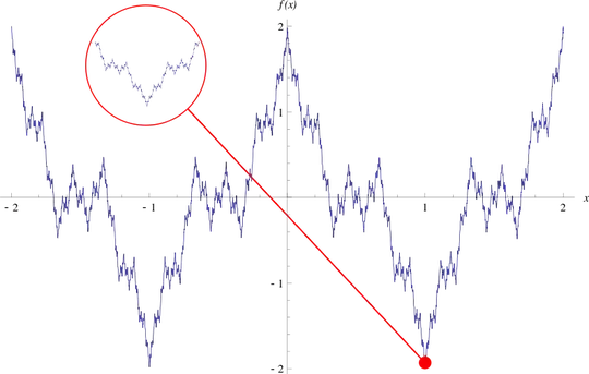

And for an example that fails at every $c$, take the Weierstrass fuction defined by $$f(x)=\sum \limits_{n=0}^\infty\left(\dfrac 1 {2^n} \cos \left(15^n \pi x \right)\right).$$
The plot of this function exhibits self-similarity (see red circle below) and looks something like this:
Git Gud
  • 31,356
    And a proof or reference it fails the monotonicity condition? – user2345215 Mar 20 '14 at 11:06
  • @user2345215 I can't prove it. But this question is a sort of 'give me an example of..' and it's not uncommon to omit proofs when this happens, especially when they aren't trivial. In any case the plot given (whatever it might be) should convince the OP. You're free to down vote my answer, I would understand. – Git Gud Mar 20 '14 at 11:09
  • I didn't mean to prove it from scratch, it should be obvious from the well known property that it's nowhere differentiable. A function continuous and monotone on an interval doesn't seem to go well with that property. – user2345215 Mar 20 '14 at 11:16
    Nice example. Similar example would be the sample paths of the Wiener process. – Cm7F7Bb Mar 20 '14 at 11:17
