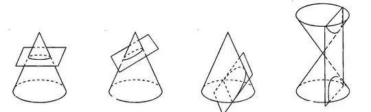

There are a few different ways of interpreting the relations between $\cos/\sin$ and $\cosh/\sinh$.
First, $\sin$ and $\cos$ parametrise the unit circle as follows: If we let $\theta$ be some anticlockwise angle from the positive real axis, if $x=\cos\theta$ and $y=\sin\theta$, then $(x,y)$ traces out a circle as $\theta$ varies. If, similarly, we let $x=\cosh t$ and $y= \sinh t$ then $(x,y)$ traces out a hyperbola (hence the name 'hyperbolic'). These may not seem immediately related, but it is known that they are both conic sections - that is, if we intersect a plane with a cone then we get a circle when the plane is horizontal, and a hyperbola when the plane is vertical. In the figure, the circle is on the left, and the hyperbola is on the right.
