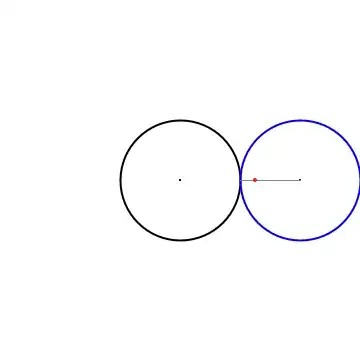

Here is a geometric way of looking at it. For the purposes of this answer, I shall be reparametrizing the limaçon as
$$r=2a(1-h\cos\,\theta)$$
(I consider $h$ here to be positive; negative values of $h$ correspond to a congruent curve reflected about the vertical axis.) I have chosen this form because this allows for a convenient phrasing of one of the definitions of a limaçon:
The limaçon is the locus of a point attached to a circle of radius $a$ rolling around the outside of a fixed circle of radius $a$, with the tracing point at a distance $ah$ from the center of the rolling circle.
In other words, the limaçon is a special case of the epitrochoid.
Your border case corresponds to $h=\frac12$. Interpreted from the epitrochoid viewpoint, this means that the tracing point is halfway between the circumference and the center of the rolling circle:
"flat" limaçon as a roulette
For $0 < h < \frac12$, the tracing point is near the center of the rolling circle, and thus the limaçon can be expected to be convex (with the extreme $h=0$ case giving the circle whose radius is twice the original). For $h > \frac12$, the tracing point "juts out" a bit, and thus we see the dimples in the limaçon:
dimpled limaçon as a roulette

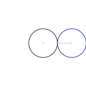

For the cardioid case ($h=1$) in particular, the cusp corresponds to where the tracing point coincides with the point of contact of the fixed and rolling circles:
cardioid as a roulette
while for $h > 1$, the self-intersection point is expected due to the tracing point jutting out of the rolling circle.
