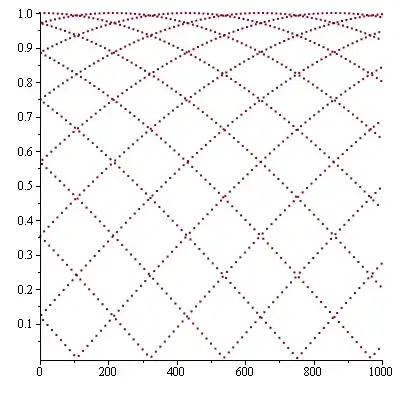

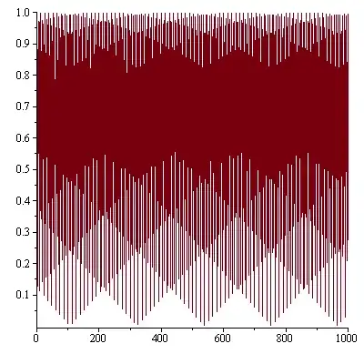

No idea if this will help but could not resist posting these striking images. Try plotting the absolute value of the real part of $a^n/2^{n/2}$ for $0\le n\le1000$.
Addendum. Even better, change the plot style to "point" so that you don't have lines joining successive points.
