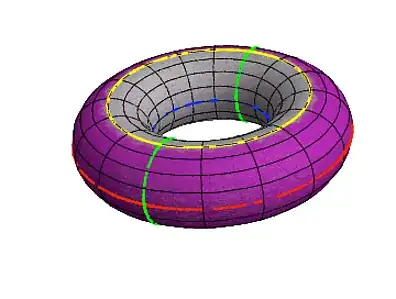

I know you're looking for an intuitive explanation, but I've always believed that intuition ought to come from concrete mathematical facts, if possible. Otherwise, you have no way of knowing whether or not the intuition someone feeds you actually matches the formal mathematics. (On that note, +1 for Joseph O'Rourke's answer.)
The Gaussian curvature, $K$, is given by $$K = \kappa_1 \kappa_2,$$ where $\kappa_1$ and $\kappa_2$ are the principal curvatures. Just from this definition, we know a few things:
  • For $K$ to be a large positive number, then $\kappa_1$ and $\kappa_2$ should both be large and have the same sign (i.e. both positive or both negative).
  • For $K$ to be zero, either $\kappa_1 = 0$ or $\kappa_2 = 0$.
  • For $K$ to be a large negative number, then $\kappa_1$ and $\kappa_2$ should both be large but have opposite signs.
Now recall that $\kappa_1(p)$ and $\kappa_2(p)$ are the maximum and minimum normal curvatures of all curves passing through $p.$ So:
  • $K(p) > 0$ means that the curves through $p$ of extremal normal curvature "curve the same way" (such as the red curve and the green curve). So, points in the purple region have $K > 0$. In some sense, the surface is shaped like an elliptic paraboloid there (like a bowl).
  • $K(p) = 0$ means that one of the curves through $p$ of extremal curvature has zero normal curvature (such as the yellow curve). So, points along the yellow curve have $K = 0$. In some sense, the surface is shaped like a parabolic cylinder there (like a bent piece of paper).
  • $K(p) < 0$ means that the curves through $p$ of extremal curvature "curve in opposite ways" (such as the blue curve and green curve). For example, points in the gray region have $K < 0$. In some sense, the surface is shaped like a hyperbolic paraboloid there (a saddle).
Torus
In fact, using Dupin's Indicatrix (which is really just a 2nd-order Taylor expansion) we can make rigorous the notion of being "locally like" an elliptic paraboloid, a cylinder, or a hyperbolic paraboloid.
Jesse Madnick

  • Maybe it would be worth mentioning what the principal curvatures are ($1/r$ and such), I think this would help people who are not conversant with the technical terms understand what you are talking about. – t.b. Oct 06 '11 at 07:00
  • @t.b.: What do you mean by "$1/r$ and such"? Do you mean the actual computations of the principal curvatures of the red/yellow/green/blue curves? – Jesse Madnick Oct 06 '11 at 07:03
    I find "principal curvature = reciprocal of the radius osculating circle" the most intuitive way of thinking about the principal curvatures. That's what I meant by $1/r$ and such. No it's not about the computation, but what does it mean for the principal curvature to be large? The radius of the osculating circle has to be small. – t.b. Oct 06 '11 at 07:04
  • Oh, interesting! I've never heard that definition before. I usually think about these things in terms of the Darboux frame, and hence in terms of geodesic and normal curvatures. – Jesse Madnick Oct 06 '11 at 07:05
  • I see. What I was alluding to is quite well explained on the Wikipedia page on principal curvature. – t.b. Oct 06 '11 at 07:10
  • @t.b.: I don't think Wikipedia is correct in this case. I think that is only true when the curve in question is a geodesic. – Jesse Madnick Oct 06 '11 at 07:14
    It is correct (I haven't learned it from there). There are two osculating circles (provided you're not at an umbilical point): one for each principal curvature. They intersect orthogonally, one is tangent to the direction where the surface curves the most and one tangent to the direction in which it curves the least. In your picture the circles indicated are the osculating circles, the curvatures are the inverses of their radii and the sign of the curvature is determined whether the center is in direction of the normal or in the opposite direction. – t.b. Oct 06 '11 at 07:17
  • Sure, but the yellow curve has zero normal curvature, so its osculating circle should have... infinite radius? Like I said, that can't be right. I believe your formula is only true for geodesics. – Jesse Madnick Oct 06 '11 at 07:19
    Yes, sorry I messed up in my previous comment. You go on the geodesics in direction of the principal curvatures and draw the circles with radii corresponding to their curvature. It's a long time since I last thought about this stuff :) – t.b. Oct 06 '11 at 07:29
