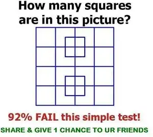

This is one of those popular pictures on sites like Facebook. I always see a huge variation of answers such as $8, 9, 16, 17, 24, 28, 30, 40, 41, 52,$ etc., yet I've never seen a definitive answer on any website.
Squares image
I counted $16$ whole squares ($4$ going down on left side, $4$ going down on right side, $8$ small squares in the centre). With this method the answer could also be $17$ if you want to count the entire shape as one big square.
I can also see the answer being $24$ if you count the smaller squares separately, as if they were floating above the main grid instead of intersecting with it.
Is there a right answer, or is it possible that there is no 'right' answer and it just depends on your counting method?

    For this to be a well-posed mathematical question you need to define precisely what you mean by the term "a square in the picture". Otherwise it is not mathematics. – Bill Dubuque Mar 01 '14 at 23:28
  • 24
    Not to take anything away from this puzzle; but $92%$ sounds made up, it doesn't help that it says "UR" instead of "Your" either. – Asaf Karagila Mar 01 '14 at 23:29
  • @AsafKaragila it probably is, I didn't make the image I'm just providing the original in its entirety. – user1092719 Mar 01 '14 at 23:35
  • @BillDubuque I don't know how the original source of the image defines what a square is, but I define squares as shapes with 4 sides all of equal length. Is that what you mean? (Apologies if it's a bad question/I'm not being clear enough). – user1092719 Mar 01 '14 at 23:40
    @user1092719 You need to say precisely what it means for a square to be in the picture. – Bill Dubuque Mar 01 '14 at 23:42
  • Right now, I would define it as all the shapes in the picture that don't have any intersections. However I'm not particularly mathematically inclined, so I'm interested to see answers that are more well explained than you'd see on places like Facebook. – user1092719 Mar 01 '14 at 23:55
    @user1092719: That would include rectangles. I'd say all shapes in the figure which can be formed by choosing line segments which are part of the picture and whose endpoints are chosen from the various points of intersection that are squares. That's what immediately comes to mind when I see the picture and the question. – The_Sympathizer Mar 02 '14 at 03:15

Thanks to Ross Millikan for helping me to find the last squares. Here is an GIF animation (344 kb) showing 40 squares from biggest to smallest:
40 squares

Ignoring the two strange squares in the middle, there are $16\ 1 \times 1$ squares, $9\ 2 \times 2,\ 4\ 3 \times 3,$ and $1\ 4 \times 4$ for a total of $30$ Each of the two strange squares has four small and one large square, five each, ten total.
The grand total is then $40$ squares.
Ross Millikan
  • 374,822
To find total squares of $n \times n$ squares, the total no. of squares in it is given by: $$n^2+(n-1)^2+(n-2)^2\ldots1^2$$ In the box above of $4 \times 4$, the total no. of squares are $$4^2+3^2+2^2+1^2=30$$
Additionally, there are $2$ small squares in the middle along with 4 even smaller squares each. They total to $10$ squares.
$\therefore$ The total squares is $ 30+10=40$

This puzzle, and others along the same vein, are generally meant to invoke critical thinking; find the correct answer with the minimum number of assumptions necessary to solve the problem. The question is asking is to find the number of squares, a square being defined as a closed object with four sides, with each side meeting at 90 degree angles, and each side being the same length.
For example, this Stock Photo shows a square window; it's mentioned as such in the description. The fact that it contains four smaller squares is irrelevant here; most people will naturally state that this is a square window (note, I didn't actually measure it, so it may not be perfectly square, but it appears as such, and we'll take it at face value for purposes of this discussion). This window actually has five squares; the frame plus the four smaller squares from the lattice that reinforces the glass.
Since the question doesn't state that any of the squares are floating or are in any other way special, and since the question also doesn't appear to be an optical illusion, we can apply Occam's Razor to come up with the obvious solution.
Using Occam's Razor, we can state the following "truths" about this image:
  • Each angle in the image appears to be 90 degrees.
  • Each line in the image appears to be unbroken, and can thus participate as a side in a closed object that has four corners connected at 90 degree angles and may either be a rectangle or a square.
  • The lines for the offset squares in the middle of the grid appear to be the same length as any of the other 1x1 squares in this grid, and their vertices appear to land exactly in the middle of the squares in the grid.
Assuming that this question isn't an optical illusion, which it clearly does not appear to be, the obvious solution to the question is 40. We arrive at this answer by enumerating all of the squares of various sizes and adding them together.
  • 1 square for the outside border of the square grid $(4\times 4)$
  • 4 squares that are 9/16th the entire size of the square grid $(3\times 3)$
  • 9 squares that are 1/4th of the entire size of the square grid $(2\times 2)$
  • 18 squares that are 1/16th of the entire size of the square grid $(1\times 1)$; the 16 aligned in a grid plus the 2 that are overlaying the grid.
  • 8 squares that are 1/64th of the entire size of the square grid $(0.5\times 0.5)$, caused by the offset squares being bisected by the grid lines.

Taking the side of each small square as ' one ' ( excluding the two squares in the middle ) ; the number of squares = 16 (1x1 squares)+9 (2x2 squares)+4(3x3 squares) +1(4x4 square) = 30 ................................The two square in the middle have small sqares , with each side having a value of 1/2 . So the total no. of squares of these two squares = 2x [4(1/2x1/2 squares)+1 (1x1 square)] =10 .......Thus the total number of squares , are 30+10 =40
