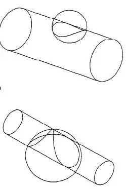

These two references might help:
(1) Murilo G. Coutinho. Dynamic Simulations of Multibody Systems. Springer, 2001. (Springer link)
Contents
(2) James Miller. "Geometric approaches to nonplanar quadric surface intersection curves." ACM Transactions on Graphics (TOG) 6.4 (1987): 274-307. (ACM link)
                Figure11
