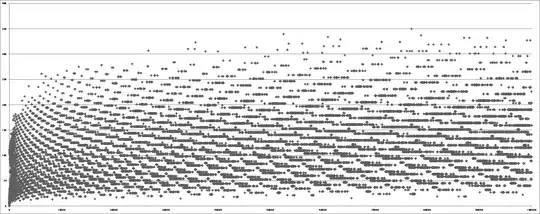

I've been messing around with the Collatz sequences a bit, and have come across a few patterns - I was wondering if there are any known explanations for these patterns.
The first is the plot of stopping times (sequence lengths) for all Collatz sequences beginning with the first $100,000$ integers. As confirmed by both the wikipedia page and by this quick Python script/Excel plot, this strange line-pattern exists in the stopping times:

Stopping Times
This is a bit less clear to understand but basically the structure is built by the intersection between the functions $x\to x/2$ and $x\to 3x+1$. You can see the dots clustered in two curves, one with a positive gradient and the other with a negative.
If we imagine any sequence represented by a series of zeroes and ones depending which function is applied and in which order, and we imagine starting from $1$ and working in reverse, then the clusters of close horizontal points occur where there is one less application of one function, and one more of the other, and these are exchanged in such a pair of positions that the overall effect upon the final integer is at its least. For any given integers there is a pair or more of digits in the binary string which can be changed to have minimal effect upon the final number.
The “strange line patterns” are a consequence for the several consecutive numbers with the same total stopping time, which I suspect is due to the limitations posed by the odd rule 3x+1. As for the every third number counting down, the other commentators explained the use of a sample size: in this case the first 100,000 positive integers, is to blame.
