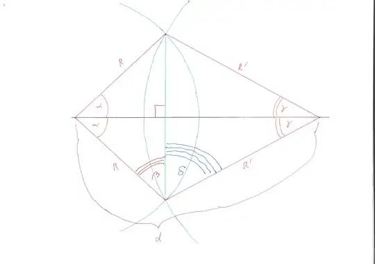

I have a version without any integrals: four acute angles related by four equations, but not an easy system to solve. Then your area is a simple function of those angles. If it will help, i can type it in. By the way, the calculation is intrinsic. The upper half plane or disc just makes everything worse.

Alright; your question, with distance scale set to $1,$ comes down naturally to four equations in four unknowns, which are angles. Area for triangles is most naturally stated in terms of angles, same on the surface of a sphere, but not in the Euclidean plane. For this material, including the distance scale $k,$ I recommend George E. Martin, The Foundations of Geometry and the Non-Euclidean Plane. For example , Theorem 32.17 on page 434 includes $k.$
Anyway, I have always worked with $k=1.$ We get four acute angles $\alpha,\beta,\gamma, \delta,$ and three (given) intrinsic distances $R,R', d,$ with the supposition that $d < R + R'.$ The four equation system becomes $$ \frac{\cos \alpha}{\sin \beta} = \frac{\cos \gamma}{\sin \delta} $$ $$ \cosh R = \cot \alpha \cot \beta $$
$$ \cosh R' = \cot \gamma \cot \delta $$ $$ \cosh d = \frac{\cos \beta}{\sin \alpha} \frac{\cos \delta}{\sin \gamma} + \sqrt{ \frac{\cos^2 \beta}{\sin^2 \alpha} -1 } \sqrt{ \frac{\cos^2 \delta}{\sin^2 \gamma} -1 } $$
After solving for the four angles, your area is $$ 2 \alpha \cosh R + 2 \gamma \cosh R' + 2 \alpha + 2 \beta + 2 \gamma + 2 \delta - 2 \pi - 2. $$

  • It would be of help! I'm trying to learn about computing stuff in the hyperbolic plane, so every different view point is helpful to me. I do not understand what you're trying to get at with your second comment, though. I know that one can see the hyperbolic plane as a "continuous version" of a $d$-tree, if this is what you mean? I.e., that area and circumference of a circle grows exponentially, just like the number of nodes and leafs of a tree vs. its depth. – HdM Feb 23 '14 at 13:42
  • Thank you for writing it down, but I'm not sure I can follow your approach. Could you elaborate how exactly the area of the intersection relates to the 4 equation system? – HdM Feb 24 '14 at 10:36
  • see http://en.wikipedia.org/wiki/Hyperbolic_geometry#Circles.2C_disks.2C_spheres_and_balls and http://en.wikipedia.org/wiki/Hyperbolic_law_of_cosines and http://math.stackexchange.com/questions/69345/the-law-of-sines-in-hyperbolic-geometry – Will Jagy Feb 24 '14 at 18:36
  • I know about the laws of sine and cosine. What I don't understand is the very last step: If I see it correctly, you use the 4-equation system to compute the angles $\alpha,\beta,\gamma,\delta$. In the next line you use that to state the area. I do not understand where the very last formula comes from. Is this some sort of ratio between the areas of the two circles? I know the areas of the circles, but how can we use that to compute the intersection area? – HdM Feb 25 '14 at 10:44
    The area of the circle with radius $R$ is $2 \pi (\cosh R - 1).$ The area of the pie slice with central angle $2 \alpha $ is $2 \alpha (\cosh R - 1).$ The are of the triangle with angle $2\alpha, \beta,\beta$ is $\pi - 2 \alpha - \2 \beta.$ The area of the lens shape, line segment as one part of the boundary, circular arc of radius $R$ the rest of the boundary, is the difference. – Will Jagy Feb 25 '14 at 17:47
