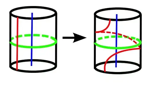

A Dehn twist is an operation so we need a before an after. In the picture below imagine the top and bottom of each cylinder are identified so that the end points of the red curve are identified, the end points of the blue curve are identified, and there is no twisting of the red curve on the left, e.g the red and blue curves are unlinked. Here is my guess at what is meant by "monodromy around a singular fiber is a dehn twist". I'll admit I am guessing here a little because I don't have the full context.
The Dehn twist operation will be to take the red curve and replace a neighborhood of it near the green curve with a curve that goes once around the cylinder. The singular fiber is meant to be blue. If we consider the two curves parallel and unlinked on the left, then on the right the linking number of the red and blue curves is 1, i.e the red curve goes once around the singular fiber.
