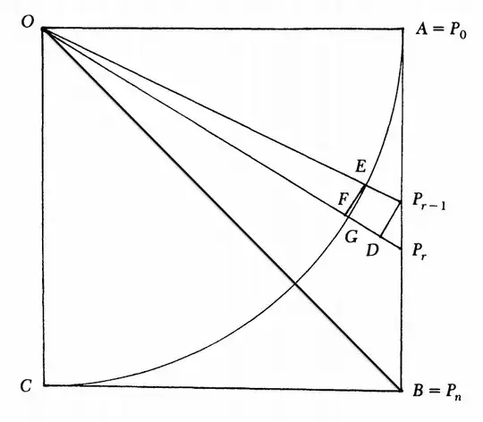

Consider a unit circle, and in particular one particular quarter-circle of it, bounded by a unit square.
Figure 5 from Roy's article, with diagonal added
We want to find the length of half the arc $AC$, which we know is $\pi/4$.
We divide the side $AB$ into $n$ equal parts of length $\frac1n$ each. Consider the $r$th such part, $P_{r-1} P_r$. Drop perpendiculars $P_{r-1}D$ and $EF$ onto $OP_r$. We have from similarity of triangles,
  • $\displaystyle \frac{EF}{OE} = \frac{P_{r-1}D}{OP_{r-1}}$ (sine of the small angle at $O$) and
  • $\displaystyle \frac{P_{r-1}D}{P_{r-1}P_r} = \frac{OA}{OP_r}$ (sine of the angle $DP_rP_{r-1}$)
so we get
$$EF = OE\frac{P_{r-1}D}{OP_{r-1}} = OE\frac{P_{r-1}P_r\frac{OA}{OP_r}}{OP_{r-1}} = \frac{P_{r-1}P_r}{OP_r \times OP_{r-1}}$$ where I dropped $OE$ and $OA$ because they are unit lengths.
Now, for large $n$ (as $n \to \infty$), the arc segment $EG \approx EF$, and the total arc length (of half the quarter-cicle) is the sum of these corresponding arc lengths $EG$, so they argued that (in modern notation)
$$\frac{\pi}{4} = \lim_{n\to\infty} \sum_{r=1}^{n} \frac{P_{r-1}P_r}{OP_r \times OP_{r-1}}.$$
Further, the numerator $P_{r-1}P_r = 1/n$ by definition, and for large $n$, the denominator $OP_r OP_{r-1}$ can be approximated by $OP_r^2 = 1 + AP_r^2 = 1 + (r/n)^2$ (actually they were more sophisticated and used the fact that it is bounded by $OP_{r-1}^2$ and $OP_r^2$, etc.), so we have
$$\frac{\pi}{4} = \lim_{n\to\infty} \sum_{r=1}^n \frac{1/n}{1 + (r/n)^2}$$
The rest is easy: use the fact that $$\frac{1}{1+x} = 1 - x + x^2 - x^3 + \dots$$ with $x = (r/n)^2$ so that our sum is $$\frac1n \sum_{r=1}^n (1 - (r/n)^2 + (r/n)^4 - (r/n)^6 + \dots)$$
Also, they had proved that in general $$\sum_{r=1}^n r^k \approx \frac{n^{k+1}}{k+1},$$ so $$\frac1n \sum_{r=1}^n (r/n)^k \approx \frac1{k+1}$$ (being equal in the limit), so that in the limit our sum becomes $$\frac{\pi}{4} = 1 - \frac13 + \frac15 - \frac17 + \dots.$$
I have been a bit even more informal in the above argument (with interchanging sums, taking limits, etc.) than they were, but this is the general idea.

  • Very nice! Thanks for the links! By combining your explanation with the article's I was able to get a pretty good grasp on the process. – Web_Designer Mar 01 '14 at 01:08
    Glad to have helped. Note that the same argument also gives, in general, that $$\tan^{-1} a = \lim_{n\to\infty} \sum_{r=1}^{an} \frac{1/n}{1 + (r/n)^2} = \int_0^a \frac{1}{1+x^2} dx$$ – ShreevatsaR Mar 01 '14 at 02:35
