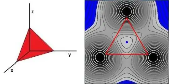

  • Picture on the left: geometry of the conditions $\;x,y,z > 0\;$ and $\;x+y+z=1$ .
  • Picture on the right: contour lines of $f(x,y,z)$ , as seen in the plane of the $\color{red}{red}$ triangle, are at $20$ equidistant levels, between the minimum and the maximum as found within the viewport
Our function $f$ in this case is: $$ f(x,y,z) = \frac{x}{3y^2+3z^2+3yz+1}+\frac{y}{3x^2+3z^2+3xz+1}+\frac{z}{3x^2+3y^2+3xy+1} $$ Applying the Purkiss Principle gives: $$ g(r,r,r)=r+r+r=1 \quad \Longrightarrow \quad r=\frac{1}{3} \quad \Longrightarrow \quad f(r,r,r) = \frac{1}{2} $$ The main problem with the Purkiss Principle, most of the time, is to prove that the extreme found is global. Or at least global enough , i.e. an absolute extreme inside our ($\color{red}{red}$) triangle. In our case, the function will become less than $1/2$, namely close to zero, for $\;|x|,|y|,|z|\rightarrow \infty$ . So it's clear that the Purkiss Principle is "violated", outside the triangle at least. These regions, where $\;f(x,y,z)\;$ is less than, say, $1/2 + 0.001$ , are colored $\color{blue}{blue}$ in the picture on the right.
The $\color{blue}{blue\, spot}$ in the picture on the right is a proof without words that the only minimum inside the triangle is (indeed $= 1/2$ ) and at its center $(x,y,z) = (1/3,1/3,1/3)$ . This finishing touch is thus an informal proof (: disclaimer).
Update : a few further details.
  • Function values close to viewport minimum are white
  • Function values close to viewport maximum are black
  • Contour grey values are just the other way around
  • Function values at the corners of the triangle $=1$ (black)
  • Function values at the edge centers of the triangle $=4/7$

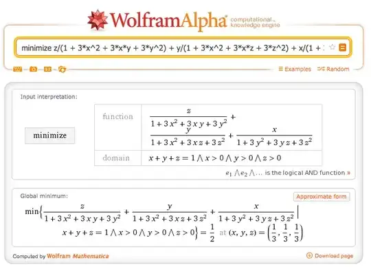

I used wolfram alpha: http://goo.gl/Cjzigc
Looks like the min is at $(1/3,1/3,1/3)$.
