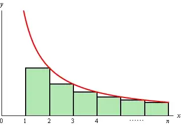

Using Taylor series is working too hard! Recall the definition of $\ln$ (or, at least, a property): $$\ln(x) = \int_1^x \frac 1xdx$$ If $x \in \Bbb N$, we also have from the definition of the integral $$\int_1^x \frac 1x dx \geq \sum_{n=2}^x \frac 1n$$
You can see that pictorially here (picture stolen from Paul's Online Math Notes):
We also have $\sum_{n=2}^x \frac 3n \geq \sum_{n=1}^x \frac 1n$ for $n \in \Bbb N$ (which you can prove by induction or otherwise), so that $$3\ln(x) \geq \sum_{n=1}^x \frac 1n$$ and thus $\sum_{n=1}^x \frac 1n = O(\ln(x))$ as desired.
