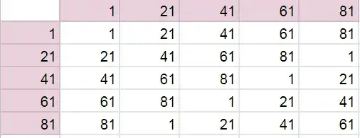

The background impetus for what follows is the multiplicative group
contained in $\mathbb {Z} / \text{100} \mathbb {Z}$.
and we stand ready to write
$\quad 3^4 \equiv 81 \pmod{100}$
From the (cyclic) group table we know that $81^5 \equiv 1 \pmod{100}$.
So,
$\quad 3^{45} = (3^4)^{11} \times 3 \equiv 81^{11} \times 3 \equiv 81 \times 3 \equiv 43 \pmod{100}$
