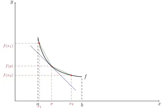

I am well aware that the question is old and already has very good answers. But, since as in the linked duplicate question here someone might also care about the intuition on how to derive the proof and the other answers are more formal, let me just add some informal explanations together with some imaginery that visualize the relationship and build intuition in the one-dimensional case.
In my opinion, the underlying idea about the proof is the link between convexity of the function and the behavior of its derivatives. When you know that $f$ is convex, you know the derivative $f'$ is monotonically increasing. This is a standard textbook result. Now, the claim that the graph of a convex function always lies above the tangent line of any of its points, can be regarded as the statement that the graph curves away from the tangent line, positioning the graph of $f$ above it.
To see that relationship, consider the following graph I produced in TikZ.
ConvexityTangentLine
We have to show the claim for arbitrary $x \in (a, b)$ and $p \in (a, b)$. Therefore, take some $p \in (a, b)$ like in the picture. First, we consider another point $x_2 \in (a, b)$ such that $x_2 > p$. We know that $f$ is convex. So, because it holds that $f'(p) < f'(x_2)$ since $p < x_2$ and $f'$ monotonically increasing due to its convexity, we have that \begin{equation} f'(x_2) \geq \frac{f(x_2) - f(p)}{x_2 - p} \geq f'(p) \end{equation} The middle term just represents the green secant line in the picture, between $p$ and $x_2$. The RHS inequality then immediately implies that $f(x_2) \geq f(p) + f'(p)(x_2 - p)$ and so the claim holds for all $x \in (p, b)$.
Now, what if we consider points $x$ for which $x < p$, i.e. $x \in (a, p)$? Take $x_1 \in (a, p)$ as in the picture. Then, we similarly have that \begin{equation} f'(p) \geq \frac{f(p) - f(x_1)}{p - x_1} \geq f'(x_1) \end{equation} again due to the monotone increase of $f'$ which is due to its convexity.
But then \begin{equation} f'(p) \geq \frac{f(p) - f(x_1)}{p - x_1} \iff f'(p) \geq \frac{(-1)}{(-1)}\frac{f(x_1) - f(p)}{x_1 - p} \iff f(p) + f'(p)(x_1 - p) \leq f(x_1) \end{equation} and voilà, we're done. Note that in the last step, the inequality sign changed because $x_1 - p < 0$.
