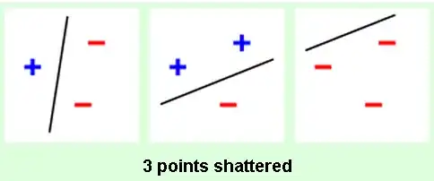

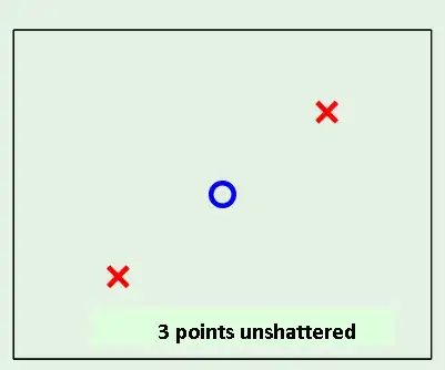

"According to the definition if H doesn't shatter the set of size k, it doesn't shatter any possible set of size k"
-> No, e.g. say your hypothesis space is all straight lines. Then there exist sets of 3 points that can be shattered using this model (any 3 points that are not collinear can be shattered), but some that cannot (3 collinear points).
$H$ = all straight lines:
Keep in mind that the VC dimension of a hypothesis set $H$ is the most points $H$ can shatter.
Your answer to the second question sounds good.

So what's the difference? You may say ok, but you can find a set of four points that cannot be shattered, but also in the case of three points you can do the same (three aligned points like 010).
I would put it like this. The VC dimension of a classification machine is larger or equal to n if at least an arrangement of n points exists that can be classified without errors for any labeling of the n points. It is equal to n if the sentence I have just written holds for every k from 2 to n but not for k = n+1.
