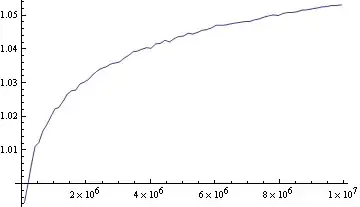

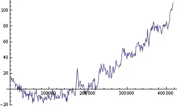

    The following two graphs suggest that $E_N$ exceeds $O_N$ for large $N$. The first plots $E_N-O_N$, and the second $E_N/O_N$, against $N$. It appears that even numbers finally gain the ascendancy for good at $N=222436$.
    Graph 1
    Graph 2

Consequences: We then have that $$O_N\sim \frac{N}{\log N} \sum_{p>2} \frac{1}{p^2}.$$ Notice this means that $E_N>O_N$, and the ratio is $$\frac{O_N}{E_N}\sim 4\sum_{p>2} \frac{1}{p^2}.$$
To keep in line with your graph above, $$\frac{E_N}{O_N}\sim \frac{1}{4\sum_{p>2} \frac{1}{p^2}}$$
