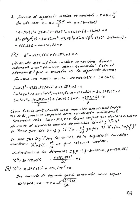

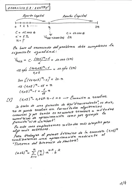

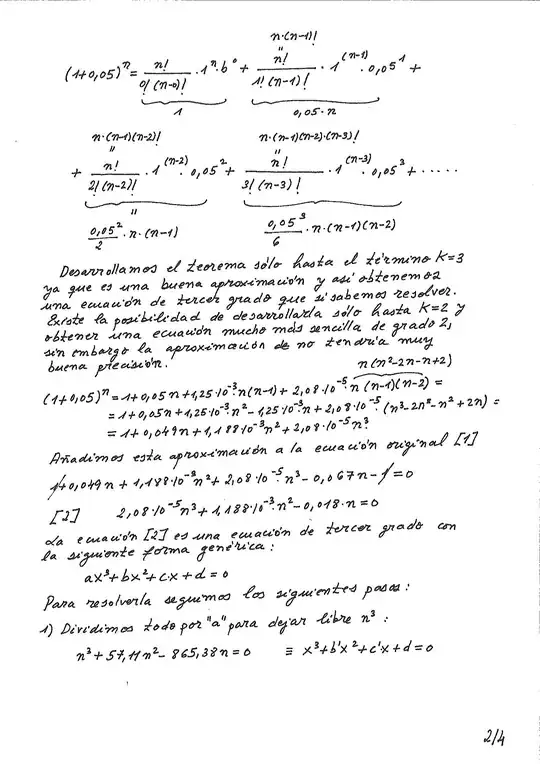

Following the proposal of @user121049, I attached the full resolution of the equation by a Newton binomial expansion to grade 3. Subsequently you have to use cubic equations solving methods and complex numbers to solve the negative root. The specific function is similar to the equation for this question: (1,05)^n-0,067n-1=0 @Deneb
Page 1
Page 2
Page 3
Page 4
