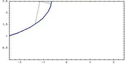

Here's a picture I previously did:
A similar derivation can be done to show that the directrix of the same rolling parabola envelopes a reflection about the horizontal axis of the catenary being traced by the focus.
