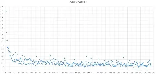

Some obesrvations:
I have tested $2^n$ up to $n$=250000 and found that $n(2)=168$ still holds. Having played with this problem a lot I conjecture that $n(m)\le168$ for all $m$.
I went a little bit further down the road and found the following values for numbers up to 340. All values have been obtained by calcuating all powers up to power 50000 and getting the biggest power with a digit missing in the result.

(2,168), (3,106), (4,84), (5,65), (6,64), (7,61), (8,56), (9,53),
(11,41), (12,51), (13,37), (14,34), (15,34), (16,42), (17,27), (18,25), (19,44),
(21,29), (22,24), (23,50), (24,23), (25,29), (26,31), (27,), (8), (28,28), (29,45),
(31,28), (32,18), (33,24), (34,34), (35,18), (36,32), (37,25), (38,17), (39,41),
(41,23), (42,19), (43,20), (44,29), (45,39), (46,32), (47,15), (48,29), (49,16),
(51,29), (52,29), (53,30), (54,18), (55,17), (56,33), (57,19), (58,31), (59,27),
(61,26), (62,19), (63,24), (64,28), (65,17), (66,15), (67,21), (68,25), (69,13),
(71,25), (72,39), (73,17), (74,19), (75,19), (76,21), (77,24), (78,19), (79,30),
(81,26), (82,25), (83,19), (84,27), (85,17), (86,25), (87,23), (88,23), (89,32),
(91,23), (92,22), (93,16), (94,18), (95,26), (96,20), (97,24), (98,20), (99,21),
(101,18), (102,17), (103,42), (104,28), (105,29), (106,21), (107,22), (108,17), (109,31),
(111,32), (112,23), (113,19), (114,16), (115,30), (116,16), (117,17), (118,20), (119,26),
(121,19), (122,23), (123,16), (124,13), (125,18), (126,17), (127,23), (128,24), (129,16),
(131,16), (132,22), (133,18), (134,21), (135,16), (136,34), (137,27), (138,12), (135,16), (136,34), (137,27), (138,12), (139,14),
(141,20), (142,19), (143,18), (144,20), (145,12), (146,17), (147,15), (148,16), (149,11),
(151,14), (152,9), (153,10), (154,14), (155,18), (156,21), (157,20), (158,19), (159,30),
(161,13), (162,19), (163,16), (164,26), (165,15), (166), (18), (167,13), (168,12), (169,15),
(171,17), (172,19), (173,17), (174,12), (175,23), (176,21), (177,15), (178,13), (179,17),
(181,11), (182,9), (183,10), (184,14), (185,24), (186,39), (187,17), (188,9), (189,12),
(191,21), (192,12), (193,13), (194,20), (195,12), (196,17), (197,34), (198,20), (199,16),
(201,12), (202,13), (203,13), (204,17), (205,22), (206,15), (207,21), (208,19), (209,16),
(211,14), (212,22), (213,17), (214,17), (215,31), (216,15), (217,12), (218,17), (219,13),
(221,16), (222,14), (223,18), (224,16), (225,17), (226,13), (227,27), (228,13), (229,18),
(231,20), (232,15), (233,21), (234), (15), (235,20), (236,15), (237,25), (238,18), (239,16),
(241,13), (242,26), (243,20), (244,27), (245,12), (246,25), (247,15), (248,10), (249,14),
(251,11), (252,14), (253,11), (254,14), (255,28), (256,), (1), (257,20), (258,16), (259,24),
(261,17), (262,19), (263,20), (264,15), (265,11), (266,20), (267,17), (268,14), (269,12),
(271,36), (272,15), (273,18), (274,14), (275,13), (276,9), (277,17), (278,11), (279,13),
(281,14), (282,14), (283,21), (284,13), (285,27), (286,13), (287,13), (288,18), (289,13),
(291,18), (292,13), (293,14), (294,18), (295,8), (296,23), (297,25), (298,15), (299,15),
(301,22), (3), (2,17), (303,19), (304,13), (305,10), (306,8), (307,11), (308,20), (309,12),
(311,16), (312,15), (313,14), (314,17), (315,19), (316,14), (317,20), (318,12), (319,12),
(321,9), (322,13), (323,11), (324,11), (325,9), (326,22), (327,13), (328,23), (329,15),
(331,28), (332,18), (333,16), (334,13) ...
