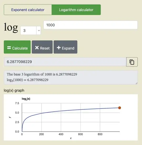

Since the poison takes 30 minutes to take effect and we only have one hour, that means we have two rounds.
After two rounds, a pig can be in one of three states:
- dead after the first round,
- dead after the second round,
- or not dead at all.
Therefore, we need to ensure:
3 ^ N ≥ 1000
We need 7 pigs!
The full article here:
https://shuaili.substack.com/p/minimum-pigs-required-to-find-one
