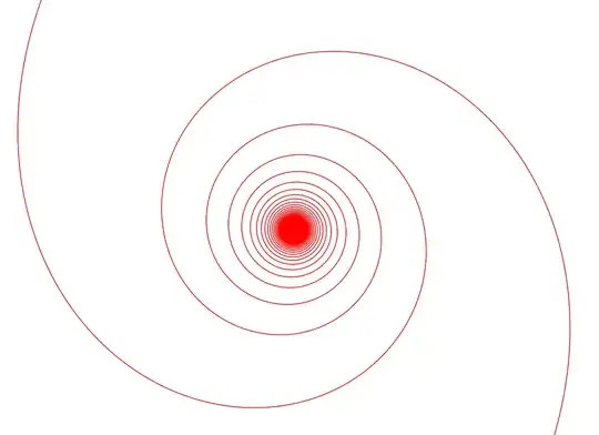

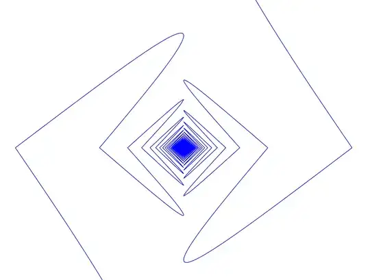

This is an old question, but here are some visual examples that help to suggest that indeed the Jordan curve theorem is actually not so intuitively obvious.
Both are not rectifiable. We have relatively good intuition about rectifiable curves but not non-rectifiable ones. These examples may seem simple, but imagine sprouting lots of similar smaller pieces along the way like a fractal. For the blue one, imagine the 'arms' intertwining more and more the deeper you go in. It would still be continuous but would be less obvious why there might not just be a way to divide the plane into three or more parts!

    How do you say that either curve is a continuous loop?? – curiousdannii Aug 18 '17 at 12:48
    @curiousdannii: They are both continuous (despite being not rectifiable); each has a continuous parametrization. If you don't get it, try the first one first: there are countably many 'rounds' so you can fit each into a rational interval leading up to zero from both sides. – user21820 Aug 18 '17 at 20:07
    I should have asked how they can be closed, for isn't that required for the JCT? – curiousdannii Aug 18 '17 at 23:42
    @curiousdannii: Yes that is a requirement for the JCT. The diagrams are merely to illustrate how a portion of the curve might look like. You can join up the ends to get a closed continuous curve, and it is not really obvious that it partitions the plane into a distinct 'inside' and 'outside'. Sorry I didn't know you were asking about the "loop" part. – user21820 Aug 19 '17 at 09:54
