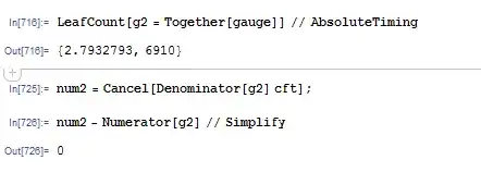

Mathematica can actually prove that gauge-cft is exactly zero.
To carry out the proof observe that expression for gauge is much smaller than the cft. Hence we first canonicalize gauge using Together, and then multiply cft by it denominator:
Sasha
  • 70,631
    I'm sorry for my confusing explanation... what's supposed to be zero is gauge-cft. – Yuji Sep 04 '11 at 14:47
    @Yuji Please see my updated answer. Computations of Cancel[Denominator[g2]*cft] took about 40 minutes. – Sasha Sep 04 '11 at 18:50
    Wow, you're a super expert on Mathematica! ... and I learned you're in fact the kernel developer. I'm honored to meet you. Please implement this trick to FullSimplify :) – Yuji Sep 04 '11 at 19:53
