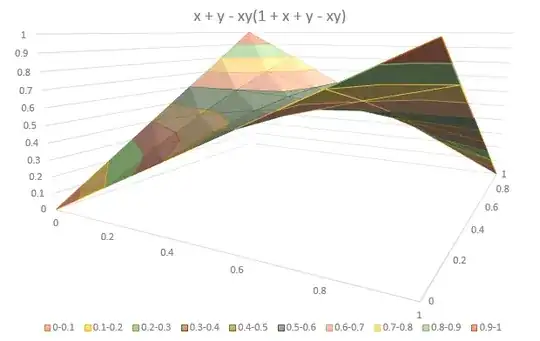

Deriving from compliment of truth conditions...
XOR
= (1 - abc)(1 - (1-a)(1-b)(1-c))
= a + b - ab(1 + a + b - ab)
