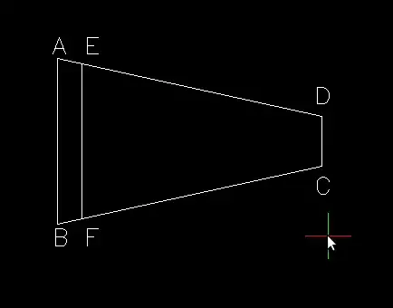

    What I did was this:
    Fig 1

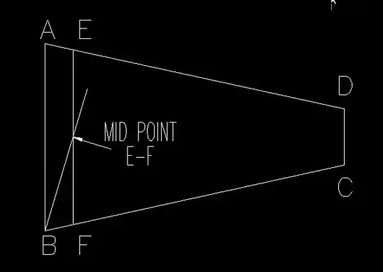

    I drew the rectangle ABCD in perspective using the measurements given above. I then drew E-F which is 7.5mm from A-B which represents the graduation at 1cm. I could have chosen any distance but have decided to use the value from the photograph.
    I then drew a line from B through the mid point of E-F.

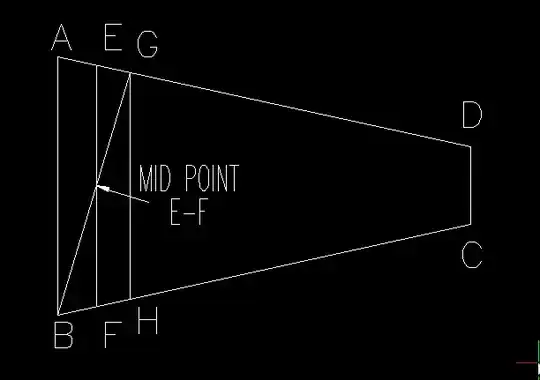

  • ...continued:I extended this line to intersect the line A-D. I then drew the line G-H.

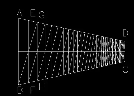

    I repeated this until I had all the divisions marking the graduation of the ruler. Happiness!

  • @DaveCoventry: Keep in mind that midpoints are not a projective invariant: there are perspectives which will map the midpoint to something other than the midpoint. In your photo it only works because all your graduation lines are still parallel in the image. If that will always be the case, you are fine, otherwise you should rather use this scale construction from my last paragraph. – MvG Dec 20 '13 at 11:34

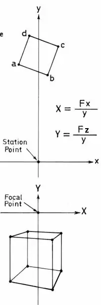

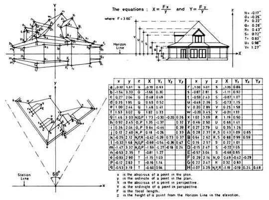

These two vector equations can define any points in perspective by inputting x,y,z coordinates of points for the object and outputting X,Y coordinates in perspective. Keep in mind that perspective projections can look different when the camera is tilted for bird's eye views. Thus, a tilt angle of the camera can be incorporated into the equations. Anyway, try to test them, then I can give you more details about their application. These are Murran's perspective equations. equations applied to a cube
equations applied to a house plan
