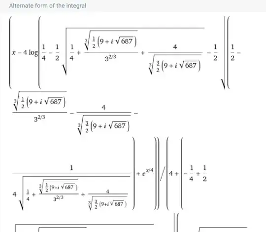

In Wolfram Alpha the integral for $c=4$ and $k=3$ can be computed with the one-liner:
Integrate[1/Sum[(E^(Round[Log[n]*4]/4))^(x), {n, 1, 3}],x]
A screen dump for the one-liner from Wolfram Alpha for Alternate form of the integral, begins:
Wolfram Alpha capture of Alternate Form of Integral
The first few lines of the output of Mathematica looks like this:
 {1/(1 + E^(2 x/3) + E^x),
  RootSum[1 + #1^2 + #1^3 &, (x - 3 Log[E^(x/3) - #1])/(3 + #1^2) &]},
 {1/(1 + E^(3 x/4) + E^x),
