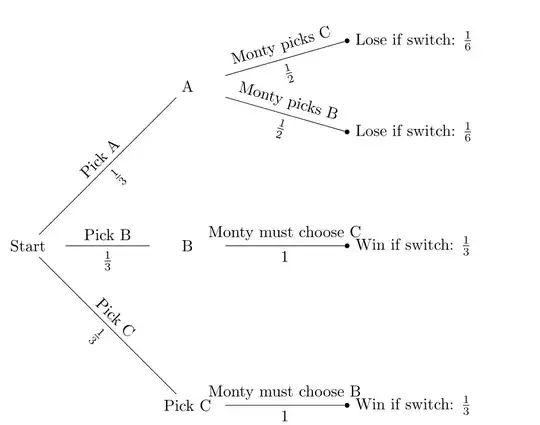

The key is: Monty knows where the car is (and will never open that door). We don't know where the million dollar is so we MIGHT open that door. For an illustration, we look at how the tree diagram differs for the two cases.
Suppose we have 3 doors, A, B and C and our car/million is in door A. We further assume we will always switch. (Once we understand this, we can extend it to $n$ doors and see that the situation will be similar.)
Case 1: Monty Hall Problem Monty Hall Tree Diagram
If we switch, $P($Win$) = \frac{2}{3}$.

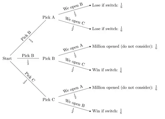

Case 2: Deal or No Deal scenario Deal or no deal tree diagram
Notice our assumption in the question is we only look at the situation if the million has not been opened. So we are in essence calculating a conditional probability. If we switch,
$P($Win $|$ Million not opened$) = \displaystyle \frac{P(\textrm{Win}\cap \textrm{Million not opened})}{P(\textrm{Million not opened})} = \frac{\frac{1}{6}+\frac{1}{6}}{\frac{1}{6}+\frac{1}{6}+\frac{1}{6}+\frac{1}{6}}=\frac{1}{2}$.
