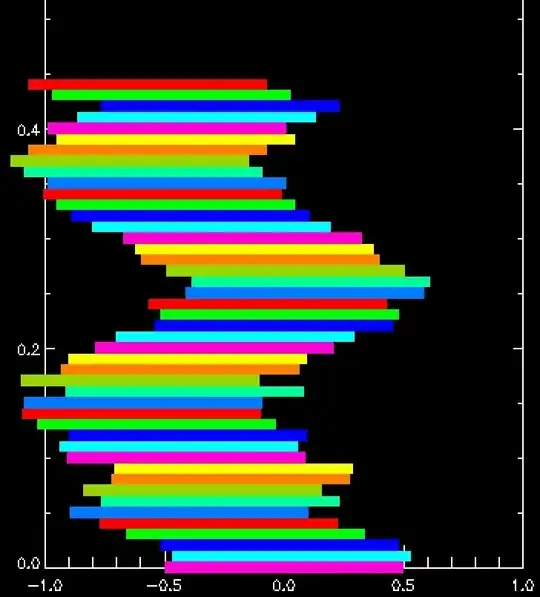

Suppose you are building a domino tower using identical pieces of unit length. You place a new domino piece, one at a time, on the top of the tower. However there is a random error in the placement of dominoes, so a new piece is placed some small random distance off the center of the previous piece, $x_{n+1}=x_n + \delta$, where $x_n$ is the horizontal position of nth piece. The characteristic size of the random error is $\sigma\ll$ 1, e.g., $\delta$ is drawn from a Gaussian distribution, $exp(-(\delta/\sigma)^2)$, or from a uniform distribution $-\sigma/2 < \delta < \sigma/2$, or from some other. Obviously some part of the tower will be eventually off balance and it will fall. Question: How does the expected maximum height of the tower, $\langle N \rangle$, depend on $\sigma$? Experimentally (on a computer) I see that the scaling law is very simple: $\langle N \rangle \propto 1/\sigma^2$ (for any distribution function used for $\delta$). How can this be derived analytically? enter image description here
  • Where did you plot this diagram ? – 0x90 Dec 14 '13 at 07:53
    IDL software http://www.exelisvis.com/ProductsServices/IDL.aspx – Maxim Umansky Dec 14 '13 at 07:54
