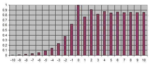

The form of $P(n)$ is interesting:
This, for example, shows that the probability of stop is strongly dependent on the first coin toss (less than 40% if tail, more than 75% if head).
