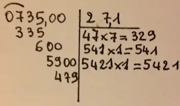

Here is how I write it by hand :
Square root of 735

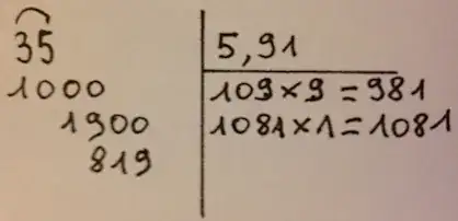

Now let me do it for $12$ and $35$ : (It took me like 30 seconds for each of them)
Square root of 12
Square root of 35
