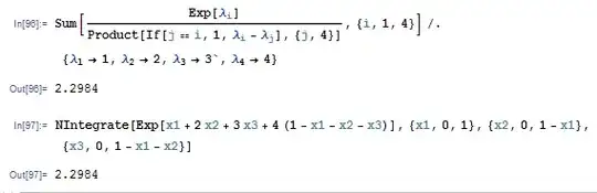

It is easy to remap the simplex into unit hypercube by changing variables: $x_1 = u_1$, $x_2 = (1-u_1)u_2$, $x_{n-1} = (1-u_1)(1-u_2)\cdots (1-u_{n-2}) u_{n-1}$, $x_{n} = (1-u_1)(1-u_2)\cdots (1-u_{n-2})(1- u_{n-1})$. The Jacobian will be $(1-u_1)^{n-1} (1-u_2)^{n-2} \cdots (1-u_{n-2})$. The integral thus becomes
$$ \int_0^1 du_1 \cdots \int_0^1 du_{n-1} (1-u_1)^{n-1} (1-u_2)^{n-2} \cdots (1-u_{n-2}) \; \mathrm{e}^{ \lambda_1 u_1 + \lambda_2 (1-u_1)u_2 + \cdots + \lambda_{n} (1-u_1)\cdots (1-u_{n-1}) } $$
Now carry out integration with respect to $u_{n-1}$. The part of exponential that depends on $u_{n-1}$ is $ (1-u_1)\cdots (1-u_{n-2})(\lambda_{n-1} u_{n-1} + \lambda_{n} (1-u_{n-1}))$, hence integration over $u_{n-1}$ gives
$$ \int_0^1 du_1 \cdots \int_0^1 du_{n-2} (1-u_1)^{n-2} (1-u_2)^{n-3} \cdots (1-u_{n-3}) \; \mathrm{e}^{ \lambda_1 u_1 + \lambda_2 (1-u_1)u_2 + \cdots + \lambda_{n-2} (1-u_1)\cdots (1-u_{n-3}) } f $$
where $f = \frac{1}{\lambda_{n} -\lambda_{n-1}} ( e^{(1-u_1)(1-u_2)\cdots (1-u_{n-2}) \lambda_{n}} - e^{(1-u_1)(1-u_2)\cdots (1-u_{n-2}) \lambda_{n-1}}) $.
Iterating over gives the answer:
$$ \sum_{k=1}^{n} \frac{e^{\lambda_k}}{\prod_{k\not= m} (\lambda_k - \lambda_m)} $$
I ran numerical simulations, which confirm the answer above:
Screen-shot of simulation performed
