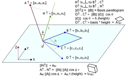

Before proceeding with more properties, one must learn to calculate volume with $N$ dimensions using $N-1$ dimensions volumes.
First of all, we don’t use here cross product, because it only exist for 3 dimensions (and for 7 … (https://en.wikipedia.org/wiki/Seven-dimensional_cross_product)). Also, we don’t use more determinants, because it would be a recursive reasoning.
For clearer understanding, let’s imagine a matrix 3x3 with a left vector $\mathbf {\vec{a} = [a_1,a_2,a_3]}$and to the right two additional vectors: $\mathbf {\vec{b}[b_1,b_2,b_3]}$ and $\mathbf {\vec{c} = [c_1,c_2,c_3]}$ in 3D space. Let’s forget the left vector $\mathbf {\vec{a}}$ for a while.
Parallelepiped volume with vectors
If the vector $\mathbf {\vec{b}}$ and $\mathbf {\vec{c}}$ are independent linearly, they are contained in a plane inside 3D space. Now we will find the area spanned by $\mathbf {\vec{b}}$ and $\mathbf {\vec{c}}$. It wouldn’t be necessary, because we could use 2D space using vector module, but it’s interesting to see how it’s possible to avoid cross product usage at all.
First, we will find a normal $\mathbf {\vec{n} = [n_1,n_2,n_3]} $that is perpendicular to $\mathbf {\vec{b}}$ and $\mathbf {\vec{c}}$ simultaneously. So $\mathbf {\vec{n} \bullet \vec{b} = 0}$ and $\mathbf {\vec{n} \bullet \vec{c}= 0}$.
Therefore
$\mathbf {b_1 n_1 + b_2 n_2 + b_3 n_3 = 0\quad}$ and$ \mathbf {\quad c_1 n_1 + c_2 n_2 + c_3 n_3 = 0} $
As it only matters the normal direction, one can consider $\mathbf {n_1 = 1}$ and solve the above equations.
Now, we need find an orthogonal $\mathbf {\vec{o}}$ coplanar to $\mathbf {\vec{b}}$ (could be $\mathbf {\vec{c}}$ , whatever) and orthogonal to $\mathbf {\vec{n}} $
To find $\mathbf {\vec{o}}$, we use the same kind of equations above with $\mathbf {\vec{n}}$ and $\mathbf {\vec{b}}$ coefficients. After we find $\mathbf {\vec{o}}$, we normalize to $\mathbf {\|b\|}$ magnitude. So
$ \mathbf {Area_{bc} = \vec{o} \bullet \vec{c}}$
Why? Because dot product projects $\mathbf {\vec{c}}$ in $\mathbf {\vec{o}}$ (normal to $\mathbf {\vec{b}}$) multiplying by $\mathbf {cos \theta}$, the angle between $\mathbf {o}$ and $\mathbf {c}$, resulting in the parallelogram height that will be multiplied by $\mathbf {\|\vec{o}\|}$, that is $\mathbf {\vec{b}}$ basis.
To get the volume (our initial goal) the normal $\mathbf {\vec{n}}$, has to be normalized with magnitude equal to area spanned by $\mathbf {\vec{b}}$ and $\mathbf {\vec{c}}$ producing $\mathbf {\vec{n_{bc}}}$, so
$ \mathbf {Volume =\vec{n_{bc}} \bullet \vec{a}}$

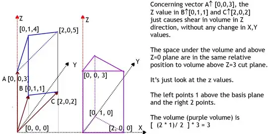

For what reason? if $\mathbf {\vec{a}}$ in column $1$ was a vector with magnitude $1$ normal to plane that contains $\mathbf {\vec{b}}$ and $\mathbf \vec{c}}$ , the volume generated would be equal (in value) to $\mathbf {Area{_bc}}$ in plane. It’s a $3D$ solid with height $1$ at right angle so the volume is the basis area $\times $height.
Generally the vector $\mathbf {\vec{a}}$ is oblique to the basis $\mathbf {\vec{b} \vec{c}}$, so if the angle between $\mathbf {\vec{a}}$ and basis $\mathbf {\vec{b} \vec{c}}$ is $\mathbf{\phi}$, the volume is $\mathbf {Area_{bc} \, * \|\vec{a}\|cos\phi}$
We know to calculate $3D$ volumes. By induction, we want to show that if we know calculate hyperplane volume in $N-1$ dimensions, we will know to calculate in $N$ dimensions.
The argument below is a kind of repetition, but within an abstract dimension, as any dimension above $3$.
We get a determinant with $N$ dimensions. In the same way, we separate the first column vector $\mathbf {\vec{a}}$ in the left (the same reasoning is also true for lines for symmetry ), Analogously the other vectors to the right forming the edges of a hyperplane $V$ with $N-1$ dimensions, the we know how to calculate the volume!
So, in the same way, we find the normal vector $\mathbf {\vec{n}}$ with a similar procedure seen above (just more equations) and we normalize magnitude vector $\mathbf {\vec{n}}$ to $N-1$ dimensions volume obtaining $\mathbf {\vec{n_v}}$.
The same above procedure can be done. The volume for $n$ dimensions with additional vector $\mathbf {\vec{a}}$ is simply:
$ \mathbf {Volume =\vec{n_v} \bullet \vec{a}}$
At short, knowing how to calculate volume and normal in $n-1$ dimensions, allow easily calculate volume in $n$ dimensions.
