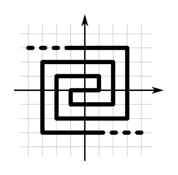

Simple explicit example of $\mathbb{Z} \times \mathbb{Z} \to \mathbb{Z}$ bijection is pictured below. This isn't a very formal definition, but I would say that it should pass as a "clear description" (in particular there are no ambiguities or doubts about whether the function is really 1-to-1 and onto).
$\hspace{70pt}$simple example of ZxZ to Z function using a double spiral
If you are looking for formulas, then the simplest way would be to go through $\mathbb{N}\times\mathbb{N} \to \mathbb{N}$ bijections. My favorite can be found here along with some other (even simpler) examples.
I hope this helps $\ddot\smile$
