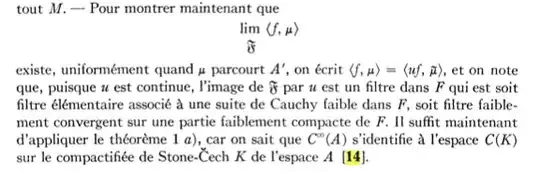

In the paper Sur les applications linéaires faiblement compactes d'espaces du type $C(K)$ we find Stone's paper Applications of the theory of Boolean rings to general topology listed as reference 14. It is mentioned only once as a mere reference for the Stone–Čech compactification at the very end of the proof of Proposition 6 (b):
Grothendieck: Citation of Stone
Here's the bibliography of that paper:
Grothendieck: Reference list
I'd like to emphasize that my intention of this post was by no means to debunk anything Johnstone writes (and as a matter of fact: I didn't!): the excerpt provided by Qiaochu explicitly speaks of Grothendieck's work on Algebraic Geometry a bit before. I merely wanted to point out that there was an interesting link that may not be as widely known as it deserves to be.
For me the above settles the matter whether Grothendieck was aware of Stone's work. Whether he was familiar with it, particularly with the aspect of spectra, it is probably something he alone could answer, unless a more specific reference is provided. However, I hope I have succeeded in making the point that he was familiar enough with the contents that he could prove a beautiful theorem with it.
