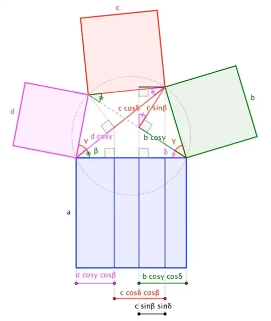

I can get close to illustrating the identity for the cyclic quadrilateral using a comparable strategy of dropping myriad perpendiculars. For simplicity, I'll just show perpendiculars dropped to side $a$:
Simple right triangle trigonometry shows that we can decompose side $a$ into lengths $b \cos\gamma \cos\delta$, $d \cos\gamma \cos\beta$, and $c \cos\delta \cos\beta - c\sin\beta \sin\delta$ (where we take on faith that all the trig signs do the correct things for obtuse angles). Thus, the area of the square on side $a$ is the sum of the areas of rectangles with side $a$ and those other lengths:
$$a^2 = a b \cos\gamma \cos\delta + a d \cos\gamma \cos\beta + a ( c \cos \beta \cos \delta - c \sin\beta \sin\delta)$$
Likewise for other sides, so that we can throw everything together and write
$$\begin{align} a^2 + b^2 + c^2 + d^2 &= 2 a b \cos\gamma\cos\delta + 2 a c \cos\beta \cos\delta + 2 a d \cos\beta \cos\gamma \\ &+2b c\cos\alpha\cos\delta + 2 b d\cos\alpha\cos\gamma+2cd\cos\alpha\cos\beta \\ &-2a c \sin\beta\sin\delta - 2 b d\sin\alpha \sin \gamma \end{align} \tag{$\star$}$$
What isn't clear from the diagram is that, with $k$ denoting the circumdiameter, $$a c \sin\beta\sin\delta = b d\sin\alpha \sin\gamma = \frac{abcd}{k^2} \tag{$\star\star$}$$ which gives the desired result. Of course, we know $(\star\star)$ is true, because the chord subtended by an inscribed angle $\theta$ has length $k \sin\theta$ ---this is effectively one proof of the Law of Sines--- but an ideal diagram would incorporate the relation.
I'll note that, by dropping only two perpendiculars from the endpoints of side $c$, one can derive the decomposition $$a = b \cos(\gamma+\delta) + c\cos(\beta-\delta)+d\cos(\beta+\gamma)$$ This may be easier to see, but having to expand the compound trig factors defeats the purpose of illustrating the target relation, since too much symbol manipulation is required.
