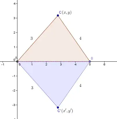

The distance between two points $P(p_1,p_2)$ and $Q(q_1,q_2)$ in the plane is$\sqrt{(q_1-p_1)^2+(q_2-p_2)^2}$.
Let us denote coordinates of $C$ by $(x,y)$. Then the distances between from $C$ to $A$ and from $C$ to $B$ will be $$\sqrt{x^2+y^2}=3 \Rightarrow x^2+y^2=9$$ $$\sqrt{(x-5)^2+y^2}=4\Rightarrow (x-5)^2+y^2=16$$ respectively. Substracting the first equation from the second equation we get $$(x-5)^2-x^2=7 \Rightarrow x^2-10x+25-x^2=7$$ $$\Rightarrow -10x+25=7 \Rightarrow x=\frac{-18}{-10}=\frac{9}{5}$$ Now if we substitute $x=\frac95$ into one of the above equations we get $y=\pm \frac{12}5$ So we find $(x,y)=(\frac95,\frac{12}{5})$ and $(x',y')=(\frac95,-\frac{12}{5})$.
As you see from the picture these two points are symmetric w.r.t $-x$ axis.

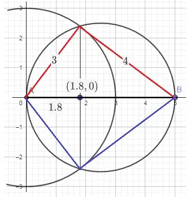

Recognize the Pythagorean triplet of sides $(3,4,5)$
Vector approach. Coordinates of C : $(x,y)$.
$$ \vec{AC}\cdot \vec{BC} =0 \tag1$$ $$ (xi+yj)\cdot[ (x-5)i+y j=0] \rightarrow \,x^2+y^2-5 x=0 \tag2$$
This is only a locus, and by Thales theorem or should contain both your points at a right angle vertex.
To isolate points of intersection draw a circle of radius $3$ to cut the locus. $$ x^2+y^2= 3^2 \tag3$$
Subtracting equations 2) and 3) we get solutions of quadratic equation which has two real roots.
$$ x= \frac{9}{5}=1.8 \tag4$$
Plug into either of the two equations for example into the second one 3) $$ y^2= 9- (9/5)^2 = \frac{9\times 16}{25}\rightarrow y= \pm2.4$$
Thus two solution points are $$ (1.8,+2.4),\,(1.8,-2.4) \tag5$$
which we can label
$$ C_1, C_2$$
