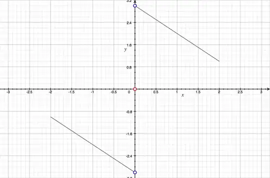

The definition here would be that $h$ is increasing at $a$ iff there is an interval $I$ about $a$ such that $h(b)<h(a)$ if $b<a$ and $b\in I$, and $h(a)<h(b)$ if $b>a$ and $b\in I$. But, really, this is a silly notion: The function below given by $$ h(x)=\left\{\begin{array}{cl}0&\mbox{ if }x=0,\\-x-3&\mbox{ if }-2\le x<0,\mbox{ and }\\-x+1&\mbox{ if }0<x\le 2,\end{array}\right. $$ is increasing at $0$.

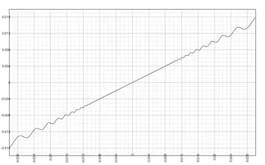

To see that indeed $f$ needs not be increasing on any interval containing $a$, no matter how small, consider the example suggested in these slides (that I mentioned in a comment above) by Louis A. Talman, on The Mother of All Calculus Quizzes: Let $g(x)$ be the function given by $g(0)=0$ and, if $x\ne0$, then $$ g(x)=\frac x2+x^2\sin\left(\frac1x\right). $$
This function is differentiable everywhere, with $\displaystyle g'(0)=\frac 12+\lim_{h\to 0}\frac{h^2\sin(1/h)}h=\frac12$, and $$g'(x)=\frac12+2x\sin\left(\frac1x\right)-\cos\left(\frac1x\right)$$ for $x\ne0$. Note that there are (both positive and negative) values of $x$ arbitrarily close to $0$ where $g'(x)<0$, so "$g$ is decreasing at $x$". This is because we can find arbitrarily small $x$ with $\cos(1/x)=-1$, so $\sin(1/x)=0$ and $g'(x)=-1/2<0$. (Note that the $x/2$ in the definition of $g$ could be replaced with any function with small enough derivative to ensure the same behavior.)
