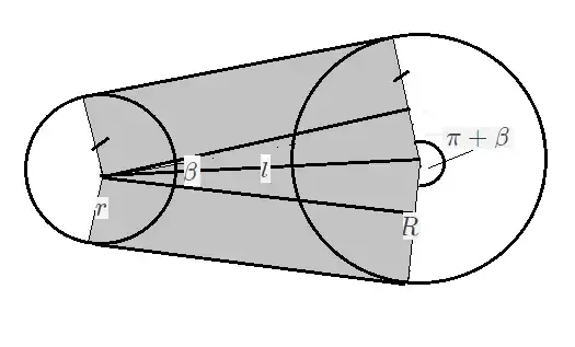

Let me take a shot at it, with a geometrical view of averaged components.
Under the assumption that in the plane the
Shaded area $A$ between direct tangents equals Average sweeping arc lengths of left side minor arcs $ {\,\bar s}$ times Average (swept) length $\bar {l}$,
$$ A= (R+r)\, l \cos\ \beta/2$$
Buffon's needle-like
Average arc length of the two left circle minor arcs shown
$$ {\,\bar s} = \frac{(R+r)}{2} \,(\pi+\beta)$$
Dividing,
$${\,\bar l}=\frac{2l \cos \beta/2}{(\pi+\beta)}$$
For special case $\beta=0: $
$${\,\bar l}=\frac{A}{\,\bar s}=\frac{2l}{\pi}.$$
