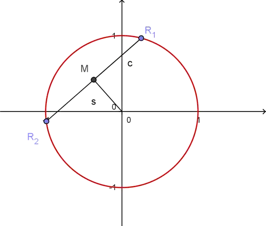

Let the points be $P_1(x_1, y_1)$ and $P_2(x_2, y_2)$, assumed to lie on an ellipse of semiaxes $a$ and $b$ with the $a$ axis making angle $\alpha$ to the $x$ axis.
Ellipse
Following @joriki, we rotate the points $P_i$ by $-\alpha$ into points
$$Q_i(x_i \cos(\alpha) + y_i \sin(\alpha), y_i \cos(\alpha) - x_i \sin(\alpha)).$$
We then rescale them by $(1/a, 1/b)$ to the points
$$R_i(\frac{x_i \cos(\alpha) + y_i \sin(\alpha)}{a}, \frac{y_i \cos(\alpha) - x_i \sin(\alpha)}{b}).$$
Circle
These operations convert the ellipse into a unit circle and the points form a chord of that circle. Let us now translate the midpoint of the chord to the origin: this is done by subtracting $(R_1 + R_2)/2$ (shown as $M$ in the figure) from each of $R_i$, giving points
$$S_1 = (R_1 - R_2)/2, \quad S_2 = (R_2 - R_1)/2 = -S_1$$
each of length $c$. Half the length of that chord is
$$c = ||(R_1 - R_2)||/2 = ||S_1|| = ||S_2||,$$
which by assumption lies between $0$ and $1$ inclusive. Set
$$s = \sqrt{1-c^2}.$$
The origin of the circle is found by rotating either of the $S_i$ by 90 degrees (in either direction) and rescaling by $s/c$, giving up to two valid solutions $O_1$ and $O_2$. (Rotation of a point $(u,v)$ by 90 degrees sends it either to $(-v,u)$ or $(v,-u)$.) For example, in the preceding figure it is evident that rotation $R_1$ by -90 degrees around $M$ and scaling it by $s/c$ will make it coincide with the circle's center. Reflecting the center about $M$ (which gives $2M$) produces the other possible solution.
Unwinding all this requires us to do the following to the $O_i$:
  • Translate by $(R_1+R_2)/2$,
  • Scale by $(a,b)$, and
  • Rotate by $\alpha$.
The cases $c \gt 1$, $c = 1$, and $c=0$ have to be treated specially. The first gives no solution, the second a unique solution, and the third infinitely many.

  • @Whuber If possible can then can you provide a diagram? I guess I have the wrong diagram in my head. – AppleGrew Jul 25 '11 at 20:49
  • @AppleGrew Done. – whuber Jul 25 '11 at 21:28
  • @whuber Superb!But if I understand it correctly then the fig. 2 has some problem. This is a 4 stage process. Stage1 scale to unit circle. Stage2 translate chord mid-pt to origin. Stage3 rotate and scale to get the origin. Stage 4 invert all. If fig.2 shows the state after stage1 then the circle shouldn't necessarily be at origin. If it shows after stage2 then $M$ should be at origin and chord ends should be $S_1$ and $S_2$. Also isn't expressing $c$ as $c=||S_i||/2$ more appropriate? I got confused by $||S_1||$, as that denotes distance of point $S_1$ from origin, i.e. half of chord length. – AppleGrew Jul 26 '11 at 06:00
  • @Apple It doesn't matter where the circle is situated. Once the problem has been transformed into the question of finding a unit circle containing two points, it has many solution methods. Mine simply rotates the points 90 degrees about their midpoint and rescales them. There exist many, many other solutions, beginning with simple compass and ruler constructions of the ancient Greeks. The points $S_i$, by the way, are points in a coordinate system in which $M$ has been moved to the origin, so indeed $||S_i||$ = $c$ = $||R_2-R_1||/2$, as shown. – whuber Jul 26 '11 at 13:35

Unfortunately, my correction on the answer of whuber has been rejected, but I'll try to explain it here.
The chosen answer is very good, but there is an error. $c$ is supposed to be the distance from point $M$ to point $R_1$. The points $R_1$ and $R_2$ are then converted into $S_1$ and $S_2$, respectively, whereby $S_2 = -S_1$. Each $S_1$ and $S_2$ are of length c, as is correctly stated. So the value of c is actually $$c = ||S_1 - S_2||/2 = ||2S_1||/2 = ||S_1||$$ apposed to $c \neq ||S_1||/2$.
It occurred to me while trying to implement the proposed solution. Using this correction, the formula works as expected.
  • Thank you for pointing that out. My exposition indeed was off by a factor of $1/2$--but the code was correct, and no other part of the solution was affected. – whuber Jun 10 '16 at 13:05
