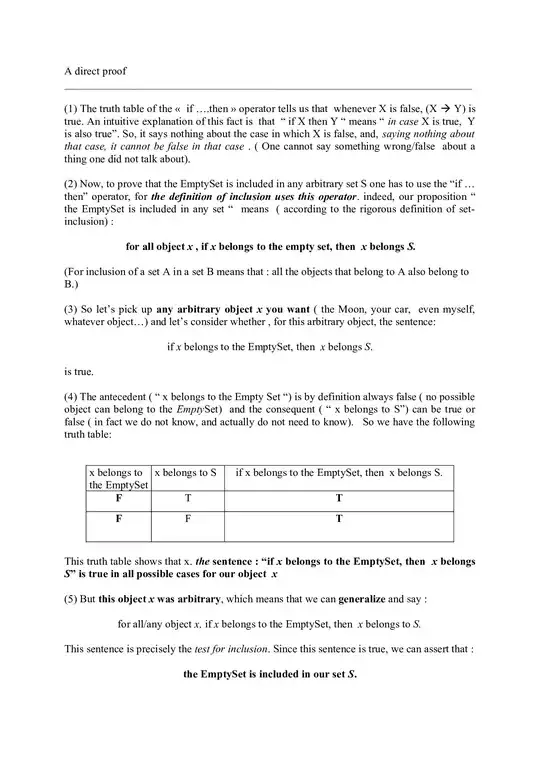

Below, an attempt at showing as intuitively as possible why one is compelled to say that the empty set is a subset of any set.
