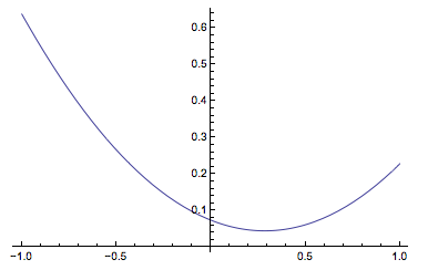

My problem is I want x0, x1 and x2 to have these values from here on and I dont know how to do (set) this. For example, if i try to plot
Plot[x0 + x1*x + x2*x^2,{x,-1,1}]
it gives me an empty plot because it does not know what x0, x1,and x2 are.

Give your solution a name, such as sol:
sol = NMinimize[{x0^2 + x1^2 + x2^2, x0 - x1 + 2.0 x2 == 1.0,
                x0 + x1*+x2 == 0.0}, {x0, x1, x2}]
{0.17748, {x0 -> 0.0739345, x1 -> -0.205098, x2 -> 0.360484}}
You want to grab the second part of this solution namely sol[[2]]:
sol[[2]]
and substitute those values into your expression:
expr = x0 + x1*x + x2*x^2 /. sol[[2]];
Plot[expr, {x, -1, 1}]
(source: tri.org.au)
Although it is certainly possible to globally set x0 = blah, and x1 = bleh, ... you will quickly find yourself in trouble if you do so. It is a much better approach generally to leave x0, x1 and x2 as global unassigned variables, and to then create a special expression like expr above with these numeric values replaced, rather than globally setting the values of x0, x1, and x2.
