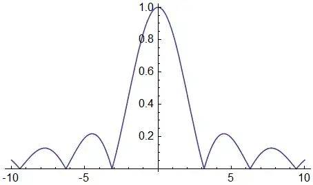

Is there a closed form (possibly, using known special functions) for the Fourier transform of the function $f(x)=\left|\frac{\sin x}{x}\right|$?
$\hspace{.7in}$abs(sin x/x)
I tried to find one using Mathematica, but it ran for several hours without producing any result.

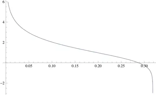

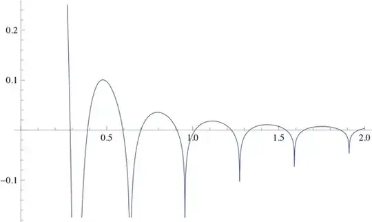

The standard result about the sinc function is that $$ \int_{-\infty}^\infty\frac{\sin(ax)}{ax}e^{-2\pi ix\xi}\,\mathrm{d}x =\frac\pi{a}\left[|\xi|\le\frac{a}{2\pi}\right]\tag{1} $$ where $[\,\cdot\,]$ are Iverson brackets. $$ \int_{-\infty}^\infty\frac{\sin(2(k+1)\pi^2x)-\sin(2k\pi^2x)}{\pi x}e^{-2\pi ix\xi}\,\mathrm{d}x =\Big[k\pi\le|\xi|\le (k+1)\pi\Big]\tag{2} $$ Note that $$ \mathrm{sgn}\left(\frac{\sin(x)}{x}\right)=\sum_{k=0}^\infty(-1)^k\Big[k\pi\le|\xi|\le (k+1)\pi\Big]\tag{3} $$ Combining $(2)$ and $(3)$ yields the Fourier transform of $\mathrm{sgn}\left(\frac{\sin(x)}{x}\right)$ in the sense of distributions $$ \begin{align} &\sum_{k=0}^\infty(-1)^k\frac{\sin(2(k+1)\pi^2x)-\sin(2k\pi^2x)}{\pi x}\\ &=\frac2{\pi x}\sum_{k=0}^\infty(-1)^k\sin(2(k+1)\pi^2x)\\ &=\frac{\tan(\pi^2x)}{\pi x}\tag{4} \end{align} $$ Since the Fourier transform of a product is the convolution of the Fourier transforms, the Fourier transform of $\left|\frac{\sin(x)}{x}\right|$ is the convolution $$ \left[|\xi|\le\frac1{2\pi}\right]\ast\frac{\tan(\pi^2\xi)}{\xi} =\mathrm{PV}\int_{\xi-\frac1{2\pi}}^{\xi+\frac1{2\pi}}\frac{\tan(\pi^2t)}{t}\,\mathrm{d}t\tag{5} $$ using the Cauchy Principal Value in $(5)$.
Plots of the Fourier Transform:
$\hspace{8mm}$enter image description here
$\hspace{5mm}$enter image description here

  • +1 great, which software did u use for the, uh, plots? – user153330 Nov 22 '15 at 15:52
  • @user153330: I used Mathematica to do the computation and plotting. I did some scaling of the image using Graphic Converter. – robjohn Nov 22 '15 at 17:18
  • What's the asymptotic behavior of the Fourier transform near its discontinuities at the ends of the interval $0<\xi<\frac1\pi$? – Vladimir Reshetnikov Mar 18 '21 at 16:11
  • Near $\xi=\frac k\pi$, it should look like $\frac{4}{\pi\left(4k^2-1\right)}\log\left|\xi-\frac k\pi\right|$. – robjohn Mar 18 '21 at 17:00
