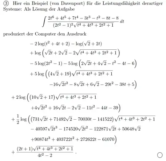

The following example I learned from James Davenport (Cambridge UK):
